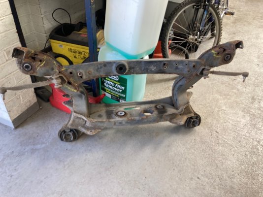

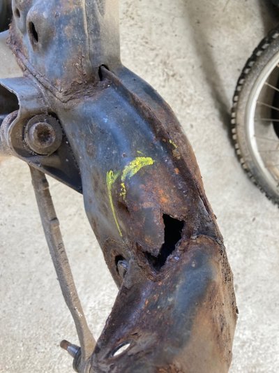

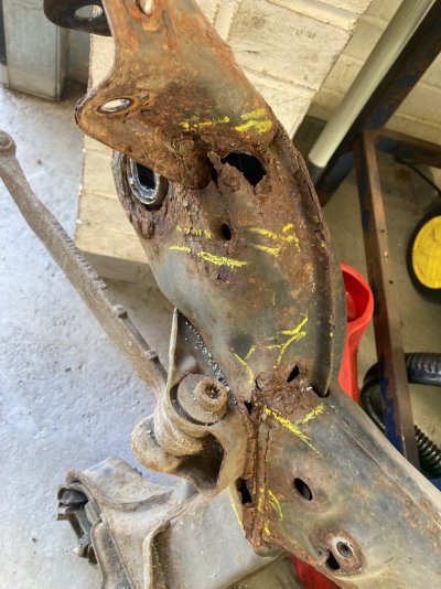

Not a new subject but a timely reminder for all owners/potential owners of these models. My 2005 very well maintained low mileage SLK55 AMG having had many years of clean annual MOT tests has just been failed on a "Major defect - Repair immediately" due to "serious corrosion and weakening" of the rear subframe near the suspension arm mountings on both sides. My local Mercedes dealer requested that the car be brought in for inspection and advised that there was a known manufacturing problem with internal corrosion on rear subframes on SLKs and that MB were aware of the problem and were replacing these as warranty items. Despite the dealer confirming the corrosion and serious weakening of the subframe (following inspection) and despite having provided service and maintenance records going back many years MB has refused to replace the defective subframe. As a result I arranged for this and with the old subframe removed I have now seen the extent of the failure which is frankly staggering, showing significant corrosion holes and failed welds (pics attached). Nothing was showing on the previous annual inspection by the same testing garage in March 2024 since when the car (always garaged) had only covered 1474 dry weather miles.

i have had the car since 2012. As the photos show the corrosion is very severe and localised - the other areas of the subframe look in the condition you would expect of a car 20 yrs old. Replacement cost was just over £4k (did a few other bits while the subframe was off).

According to the dealer there was a manufacturing issue with subframes on some models causing internal corrosion hence nothing apparent visually until failure. the pics of my subframe show the unaffected areas look right for age but the failed areas are most certainly not what would be expected of a high performance car produced by a prestige manufacturer. And the failure to issue any advisory or safety inspection recall is in my view inexcusable hence my cautionary advice to other owners to check their cars.

I would argue the subframe failures are a manufacturing issue. It will be down to poor quality steel of too thin a gauge and no internal rust prevention. As for resolving the issue I seem to remember someone commenting that replacement subframes were heavier so thicker steel.

I have poked my inspection camera into the frame and seen nothing too bad in there but I 100% agree . I have already sourced all of the bolts and links required for a subframe overhaul , whether that be a new one or a major refurb on the original. 👍
