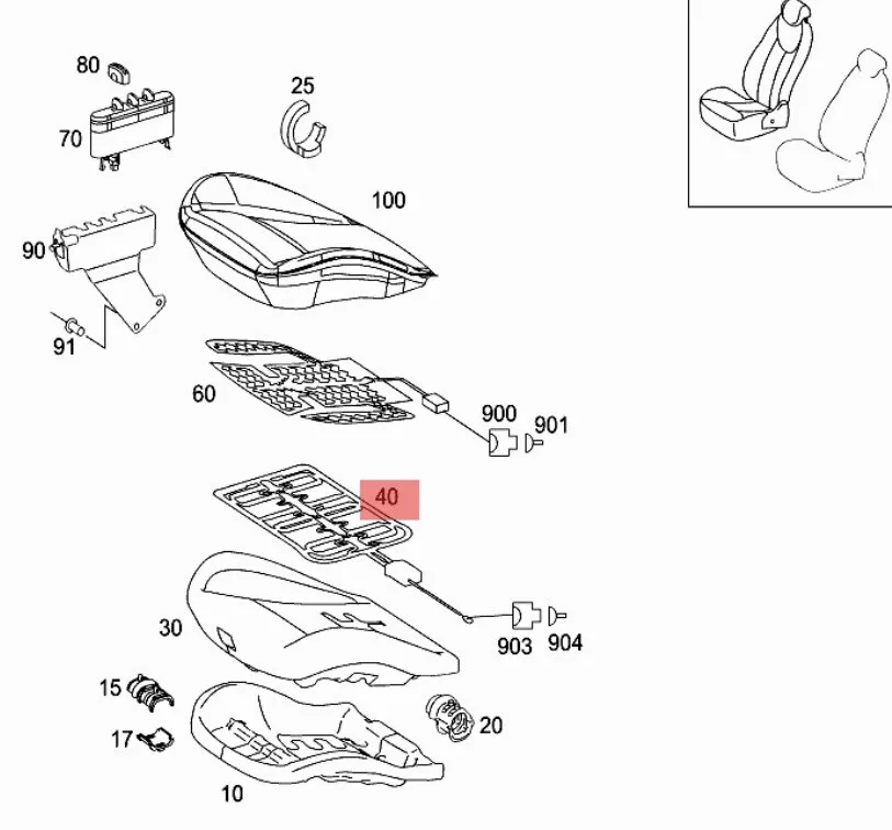

The Front Passenger Seat Occupancy Sensor is a mat of sensors inside the passenger seat. It's aim is to detect the presence of a person (the sensors are sensitive to pressure), and arm the passenger airbag. This prevents the passenger airbag from deploying in the event of a crash when the passenger seat is unoccupied. You can buy a cheapo Chinese emulator on eBay instead of replacing a faulty sensor mat, but I advise against it.
It's item no. 40 in the drawing below:
But, again, the faulty component needs to be confirmed by STAR diagnostic first.
