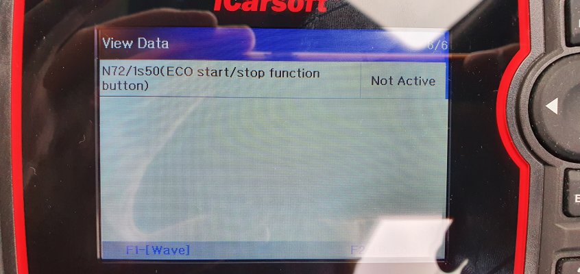

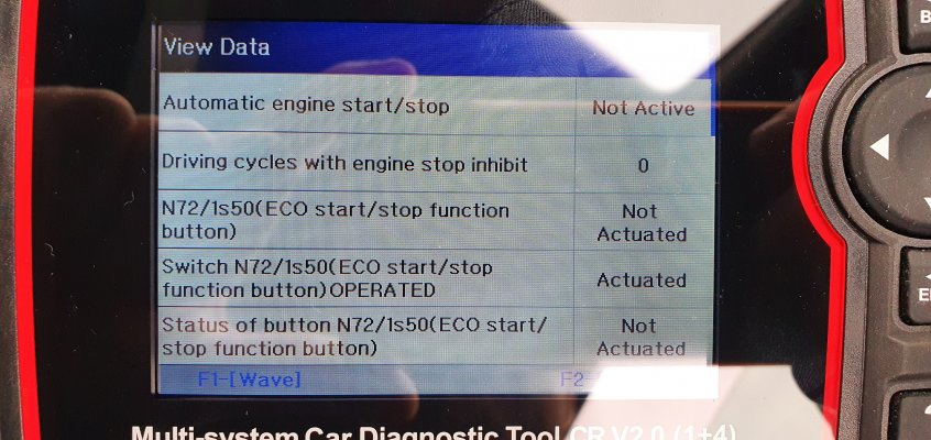

I have found this data. At this point I had pulled up with ECO light green and the ECO kicked in stopping the engine. This was prior to attempting to pull away when the engine 'should' start back up. (it didn't start back up btw - I had to disconnect and reconnect the battery)
I'm not entirely sure what i'm looking at but I see that the status of the button N72/1s50 is not actuated / not active?

It seems that your Stop/Star deactivates itself. This normally happens when the battery is discharged, or when one of the perquisite components is faulty and provides implausible data. It's odd that it happens exactly when Stop/Starts tries to restart the engine, possibly there's something in the starter motor operation that triggers a failure of the Stop/Start, perhaps due to excessive current draw. Can you post the other (unrelated) fault codes? Also, which model of battery did you fit, and has it been tested - what voltage does it show when the car won't start? And, you should be able to go further into the various options on iCarsoft, e.g. 'requirements for automatic engine start', and look for any clues there.
If you go into "Eco stop/start - requirements for automatic engine start" what do you seen?
Or can you view all live data for this system when running, and then see what happens after the stop?
