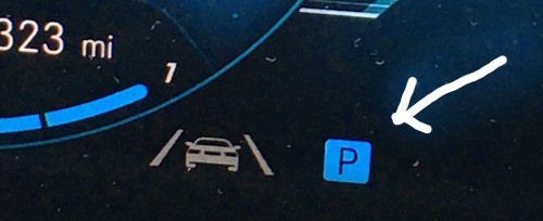

Hi all, I need some help regarding a symbol that just pops up now and again - It appers as a small "P" in a box with a blue background as in the photo , I have no idea what it means or why it appears, I have search the manual with no luck at all - just hope that some of you guys know what it is.
Park assist?
It's seen a parking space you could fit into? Would only appear at low speeds, when passing parked cars either side?
Park assist as ToeKnee mentions. Check my video on how to use it:

Thank you for your suggestion that the problem maybe Park Assist - on some occasions an arrow both left & right appears either side of the symbol - Maybe I have selected Park Assist by mistake, I will check it out tomorrow and let you know.

The arrow indicates that a space of the correct size as available.
Thanks for your help "Spot on" the video was very helpful
