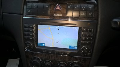

This is my sat/nav / command unit. It has a CD changer currently installed and that does show track names etc. Is this one capable to add a device?
Thanks.

estate-agent - thats a NTG2, and it has the AUX facility. You either have a 3.5mm aux socket in the glovebox, or a connector to add a lead in the footwell wiring duct, or nothing and you have to wire to the back of the COMAND.
Many people miss the socket so have a good look in the glovebox, on the side near the door first
