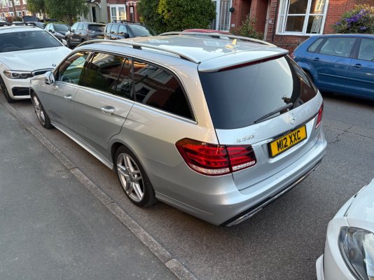

What clearance would you say you have from wheel arch to top of tyre. I know all vehicles run different size wheels and suspension components. What would you say is the recommended clearance on a s/w212 with 16" wheels SE suspension?
AT least they turned up at your premises with the aid of you to put them right ay 🙃
Is the 212 the same as the 211 where there are two positions on the strut to fit the spring mount?
First measurement, road to arch, second measurement centre of wheel to arch. I am not confident measuring top of tyre to arch. It’s too wobbly trying to find horizontal point across the tread.
18” wheel, staggered setup. Stock AMG line car, no modifications at all. My wife’s daily beater.
Although she has moved into her summer wheels now…
