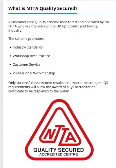

I had mine fitted and coded by an indy who were NTTA accredited and all i see is the red towball icon on dash which goes out once car starts. I travelled a long way to get my Towbar fitted properly and even with fuel and Hotel stay etc was still same price as indy who had no NTTA but said they could code.
Beware places who use the logo but not registered on proper site, as they have either been kicked off for shoddy work or just faking logo. I fitted all my own prev bars but left the Merc due to the coding. Main Dealer can code for £80 - £150 but don't like to as it's aftermarket. Very easy towbar to fit on a S213 tiny bumpercut and make sure they support AdBlu tank!!
