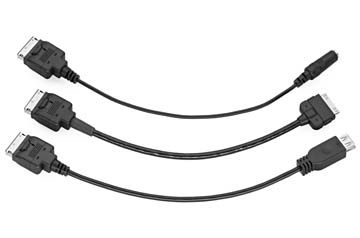

As per the thread title really - phoned MB and they literally don't have a clue! I want to connect my Android phone (USB-C) to the Media Interface connector in my Glovebox (I have a C63 so it has Comand Online as standard) such that I can play Spotify through the screen/steering wheel controls etc.
And before anyone says Bluetooth...I currently do it this way but the audio losses through Bluetooth are getting on my nerves, and I gather a direct connection is much better.

Have you considered using the standard MB Micro-USB cable, with a third-party Micri-USB to USB-C adapter?
E.g.:
https://www.amazon.co.uk/ARKTEK-Adapter-Keychain--MacBook/dp/B078S51LVP/

@markjay Looking at that link you sent it appears it's a normal USB not a micro. Would I therefore need a normal USB - USB-C adapter? I've had funny experiences before with using those adapters and it not transmitting the signal properly - is it a tried and tested solution?
Older Mercs used a proprietary media connector in the glove compartment.
Newer Mercs use standard USB port for the media interface.
Your W204 C63 with COMAND NTG4.5 and Universal Media Interface (UMI), should have both types of connectors.
As far as I know, the cable that will give you control over your phone from the steering wheel is the one connecting to the UMI connector in the glove compartment, not the USB cable connecting to the USB port in the armrest.
Comand UK will know which cable you need, give them a call.
