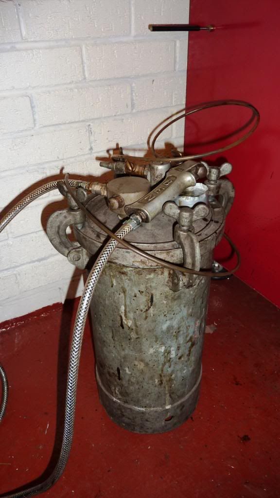

It’s a big, messy and tedious job to Waxoyle properly... I always use it 50% thinned in the cavities and use a high pressure pot to squirt it in there with a long 5mm lance. By adjusting the air/fluid mix on the pot I can get it to almost atomise! In fact when I recently did my MX5 I noticed that the interior light on top of the windowscreen was dim, and when I checked I found the inside of the lens had a coat of waxoyle! As I was poking the wand (OHHHH EERRR) inside one of the cavities it must have gone up inside the window screen pillar!

Sure looks like you've a professional job there with your pressure pot. Top job, T.

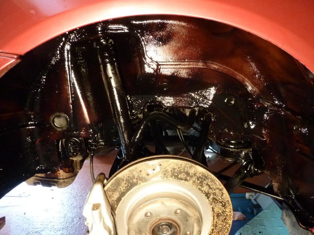

Well I am going to disagree :D I have been using Waxoyle since 1978 when I first used it on a lancia Beta. I sold that car 25 years later with all its original panels, how many lancia cars of that era can claim that! I used it on many cars since and never had a problem with corrosion, unless I missed a bit, usually inside a cavity. I will agree that it stays slightly sticky, but I don't feel it attracts the dirt anymore than anything else. It does need to be re-applied though in areas of high abrasion like wheel arches. I give my cars a jet wash and top up every few years.
I also like to use it on suspension parts. I did the underside of an early MK1 Audi TT when they first came out, and when I came to sell it, I wanted it to look mint, so I took the wheels off and sprayed the suspension components with some white spirit and let it soak in... and then jet washed it off. The suspension components came up like new. :thumb:
I know there are other products on the market, and if you listen to the marketing guys they are always the best (don't they always say that if they are trying to sell you something!!) But I will be sticking with Waxoyle as it has a proven track record for me, and it works. I don't have enough years left to test another product for 35 years! ;)

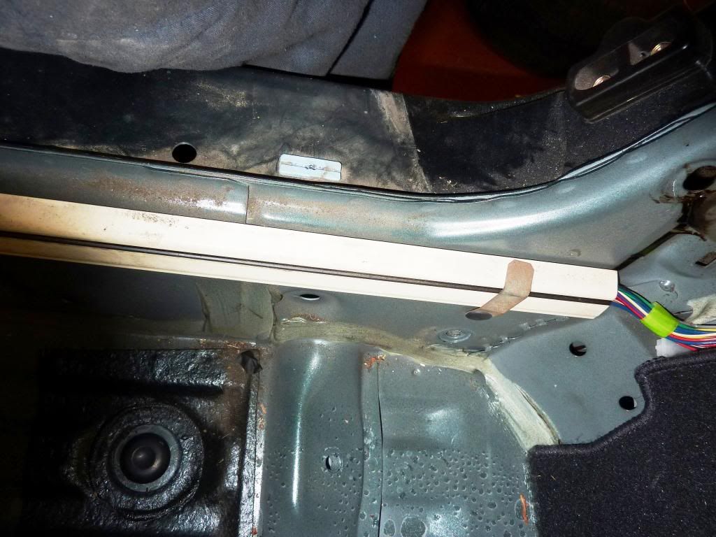

I inspected a Mini a few years ago that was an older restoration. It had had extensive welding and panel replacement, and had been sand blasted back to bare metal. The shell had then been seam sealed, undersealed, and then painted. Unfortunately despite all the work and sand blasting, the corrosion was already in many of the joints and within a few years there was rust bubbling all over the place.
A couple of months ago I inspected a lancia that had a £15,000 restoration 9 months previous. To look at it, fantastic job, but the owner noticed some rust stains in a few areas… when I looked, it had been sprayed with a rubbery type coating on the underside, which looked great but was already flaking off… Worse though on that particular car was inside the sills. I used a tiny video camera to look in the cavities and was horrified to see just gobs of cavity wax in there, and rusty metal. Also parts of the inner sills missing! Looking at the photographs the company had sent him, they were of a different car being restored, and you could just make out areas where the paint was a different colour! That one is now subject to a court case with the restoration company.
Incidentally, the small video cameras you can now get on the end of a 3 meter lead are great for looking inside cavities! They are only 10mm diameter and have an LED light on them, and plug into a laptop. Great for inspecting and taking pictures/ videos inside cavities and you can get them on Ebay for less than £10!
One of the things I like about Waxoyle is its ability to creep into Joints. I did an MX5 recently (what a little rot box they are!) and when I did inside the sills, I could see the Waxoyle coming out the seams on the top! Here is a picture before; unfortunately I didn’t take one after with it leaching out the joints! I also did inside the rear wheel arches, and noticed it running out the outside lip! Also one inside a door using the small inspection camera.

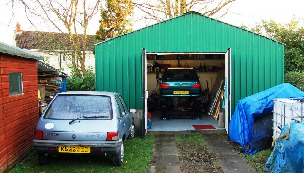

You are right about the 205… The picture below is of my mates 1992 205 Diesel and his wife’s 2000 106 Peugeot. The 205 has done 350,000 miles, the last 100,000 mainly on chip fat :D:D There is not a single patch of rust on it anywhere; the underside of the body is like new. Contrast that with the 106 which is rotten all over. I am not sure if this is down to the steel used or the way the body was treated at the factory with the paint finish and sealer. There is minimal rust protection on the 205 and I can’t see any evidence of wax injection into the cavities.
