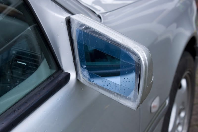

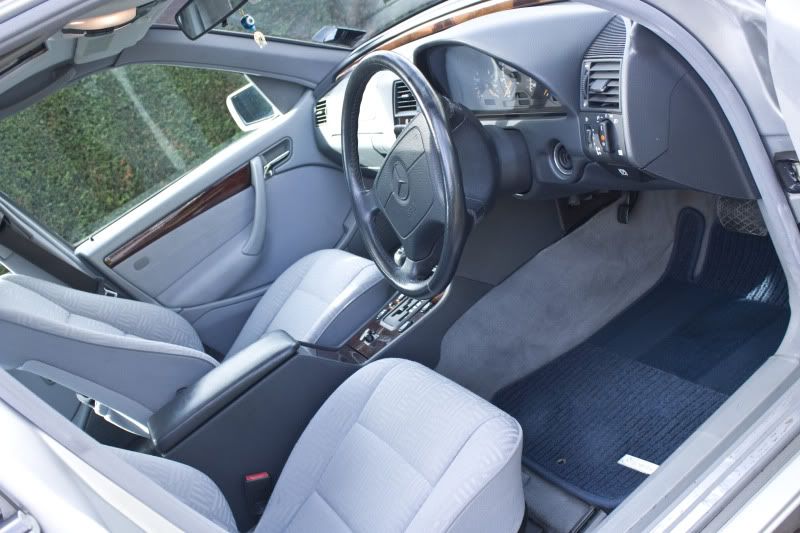

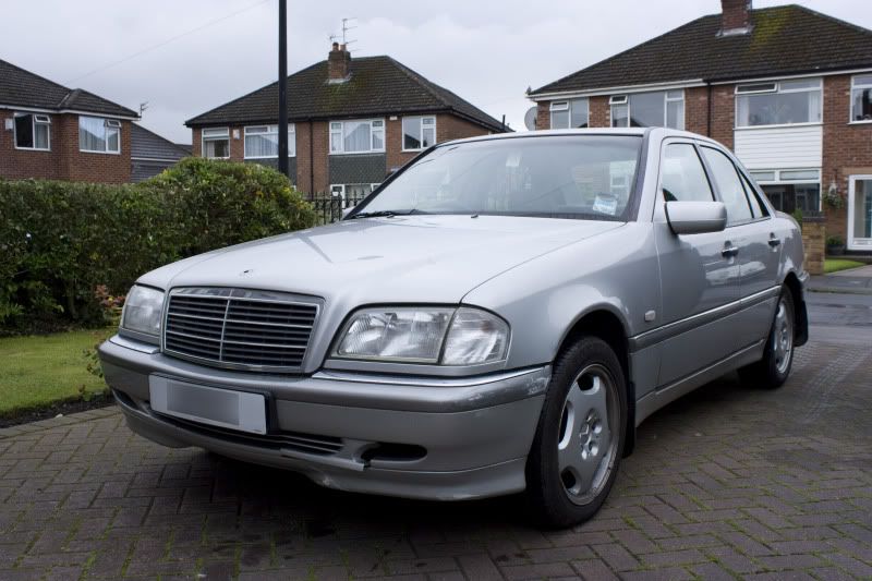

I'll start from the top. The owner of this car first contacted me with a view of tidying up the paintwork on his mother-in-law's Merc C180. When he arrived I quickly realised this was going to be no ordinary detail! I inspected the car throughout when my client got here, and we decided on a course of action. As of late I've had alot of "can you just" jobs added onto the original, which I don't mind, and put that down to people seeing more and more of what I can do (despite me avoiding DW like the plague)
So it changed from an enhancement / minor correction detail which you've seen me post quite often, to a full fat 2 stage polish with paintwork, dent removal, replacement badges, new stereo, new wing mirror and wheel refurb!!

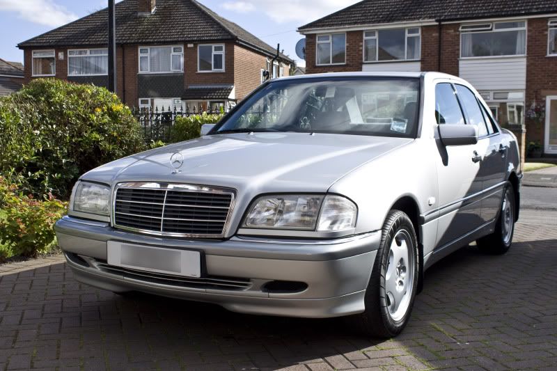

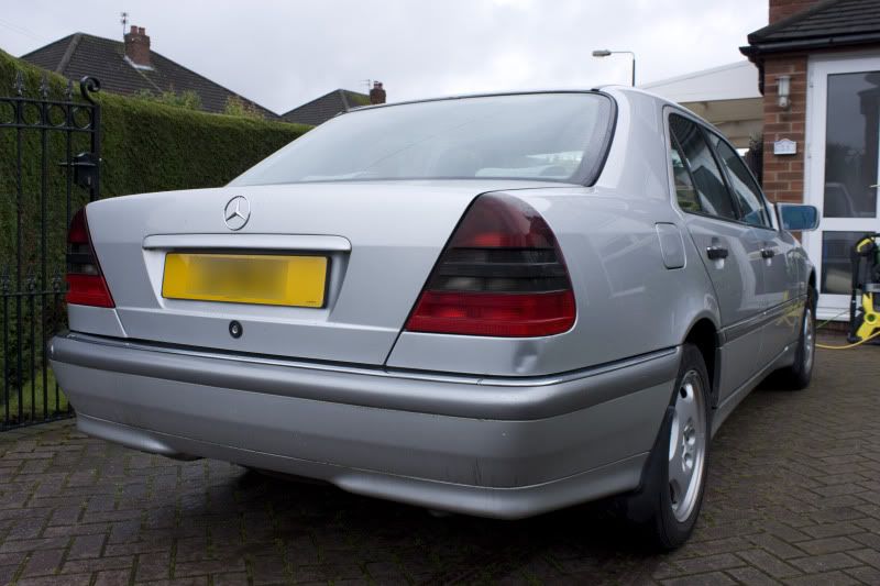

Started out like this;

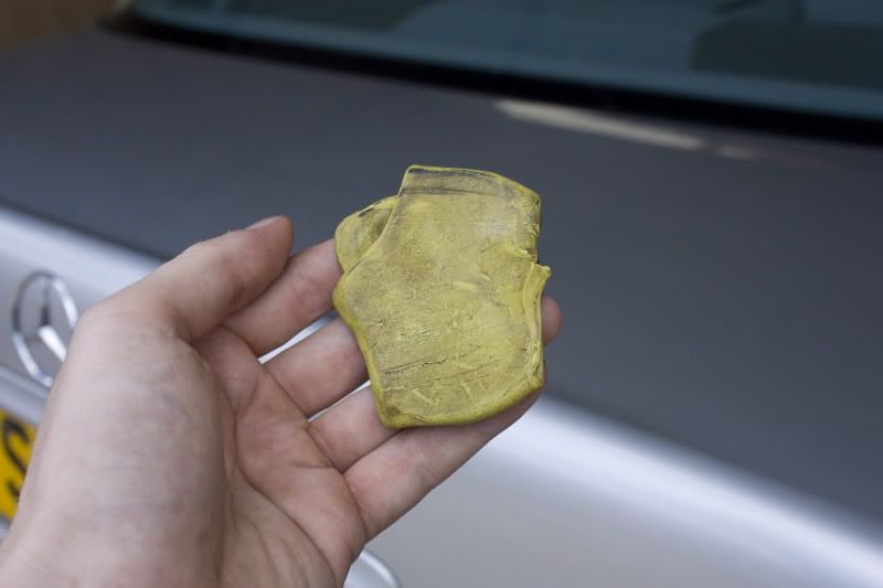

So I got it prewashed with ph-neutral snow, mixed with a little APC to give it some bite around the small work - the gunk oozing out of the window rubbers and around the roof guttering.. proper manky stuff. Didn't take a picture, hands were too dirty. It was washed using the two bucket method - why? even though the paintwork was goosed, I didn't want to create even more work for myself!! Then de-ironised and clayed when indoors;

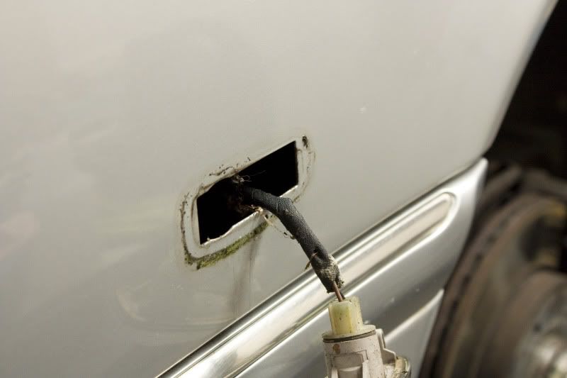

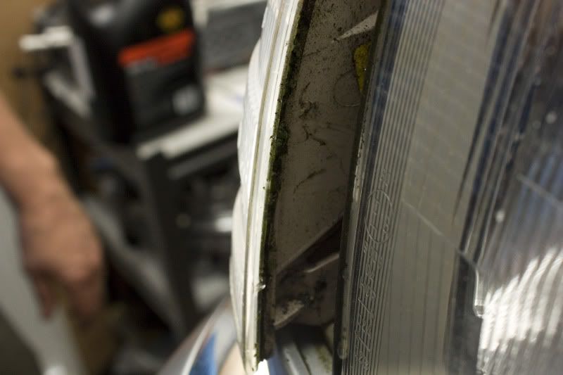

Cleaned all these panel gaps out around the lights and got rid of the green slime that had gathered on the inner edge of the light. Then I clayed the car.

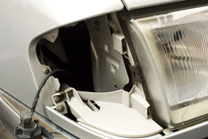

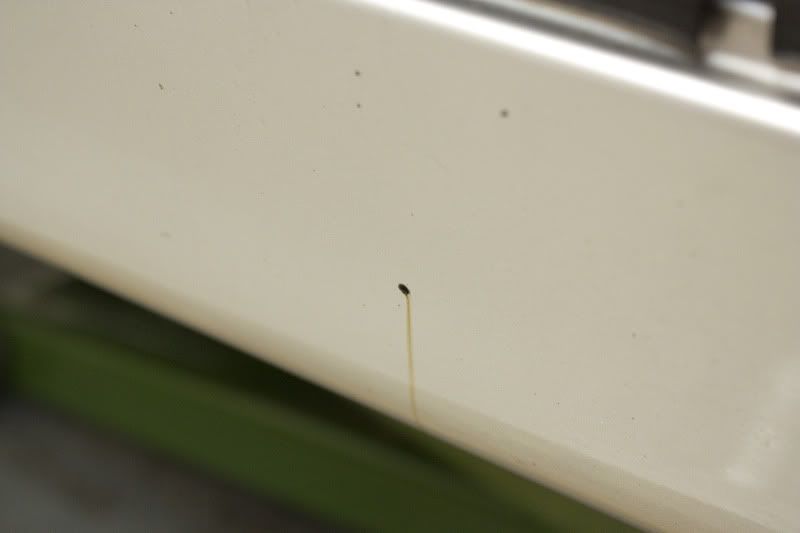

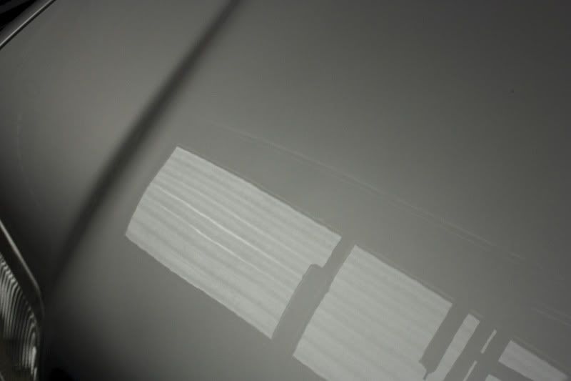

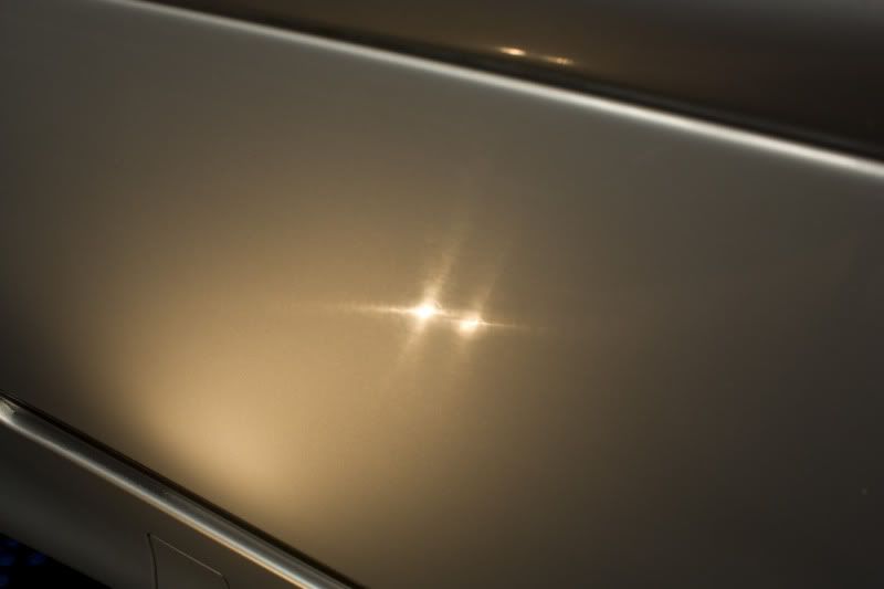

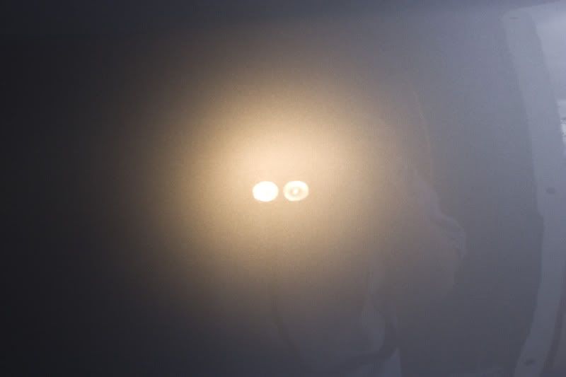

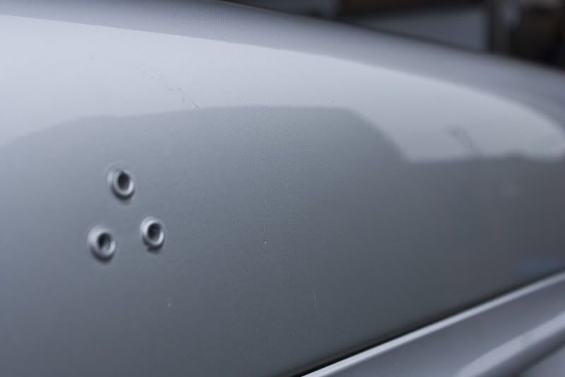

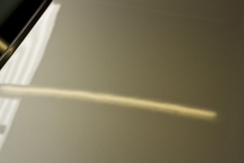

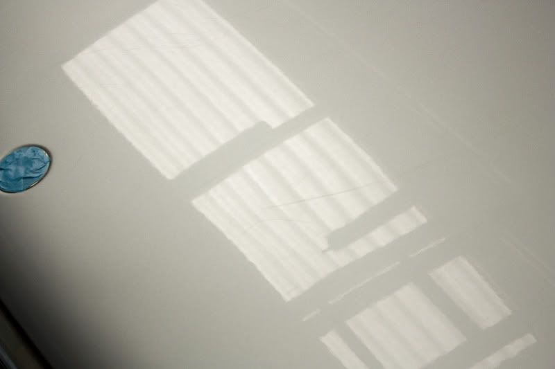

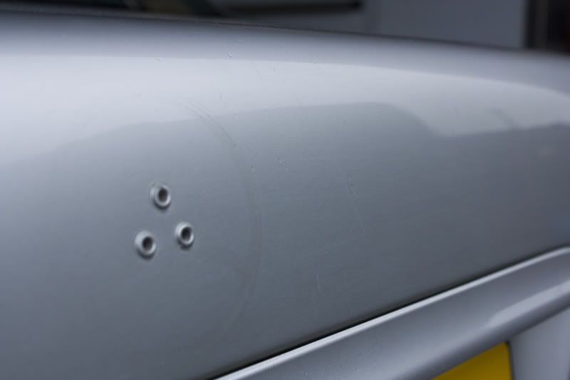

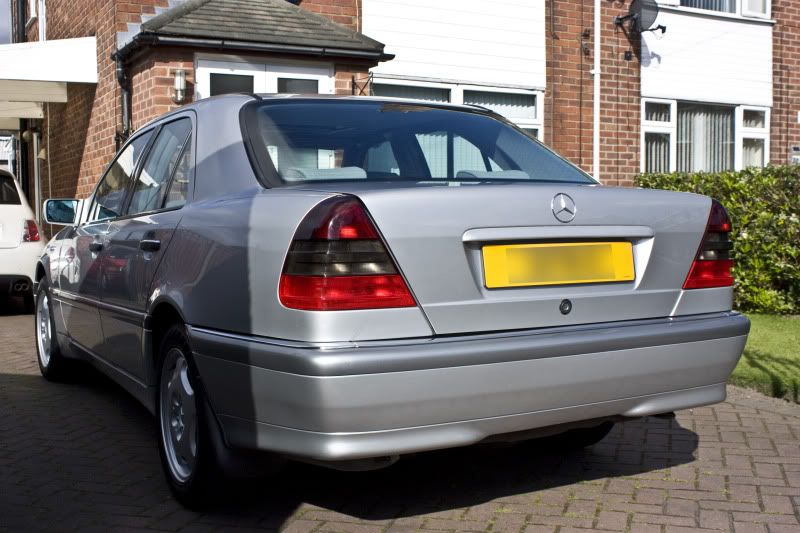

Taped the car up and started to take some paint readings - some panels had seen paint over the years, could see that without the gauge :lol: thanks to some lacquer runs and the usual kind of poor worksmanship that is too common these days :( Once it was taped up and ready to go, I took shots as I was going along.. starting with the damage;

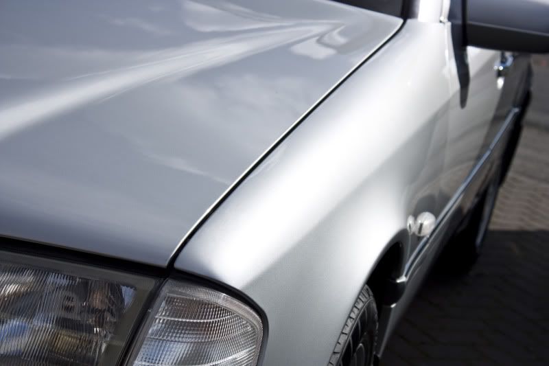

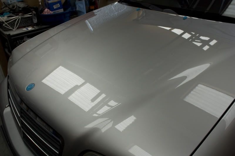

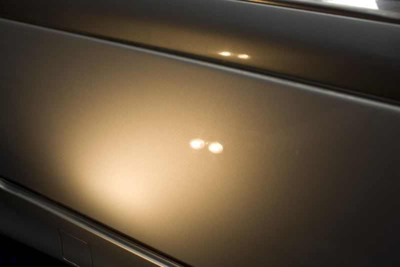

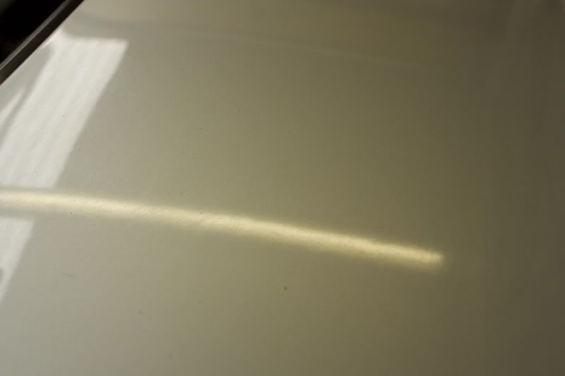

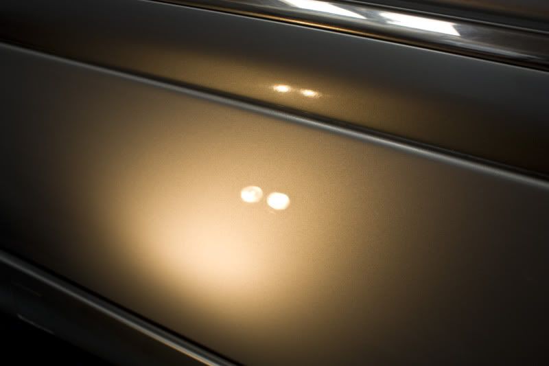

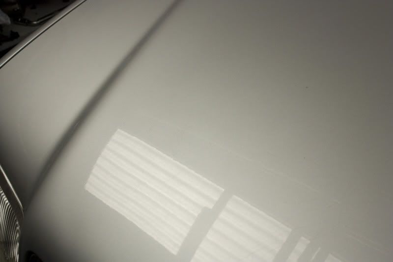

After polishing, colour looks totally different - it was flat in the above shots, now look at the gloss, and no scratches;
Moving around the car now..

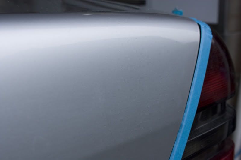

After the first stage;
Final refinement;

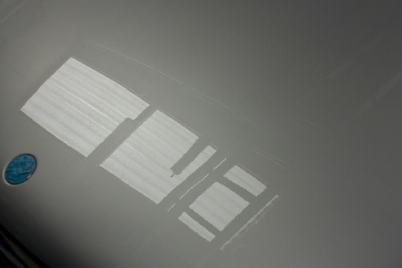

The boot, under the strip light before and after (disregard the orange peel, I wasn't tackling that)..

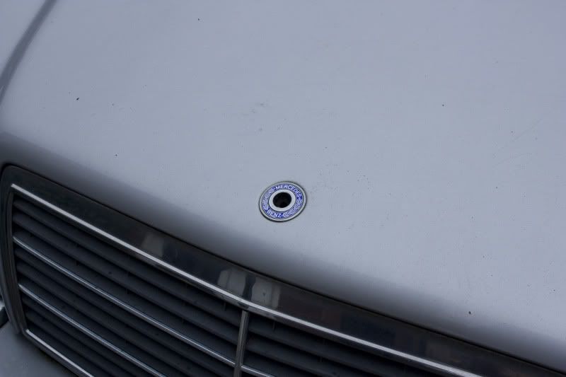

Whilst the badges were off..
Look at the dullness, as if it's been cleaned with an emery cloth :(
Gloss returned;

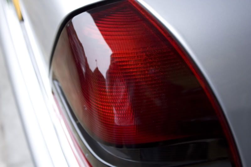

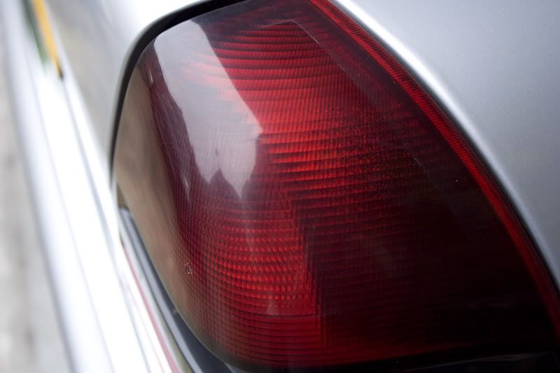

Rear lights were the same - being plastic, they only needed a single stage, but the difference is still night and day - if I hadn't told you, you would more than likely think they had been replaced :)

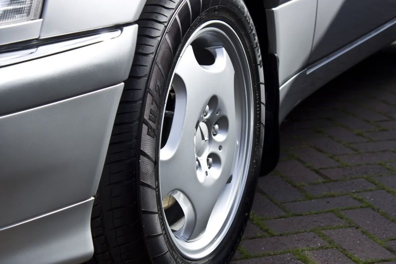

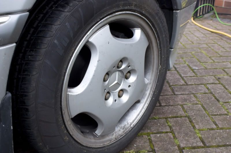

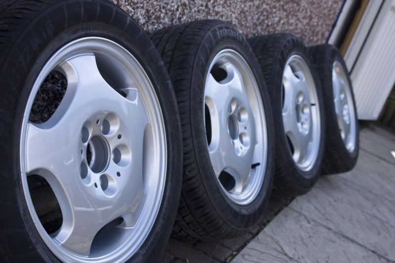

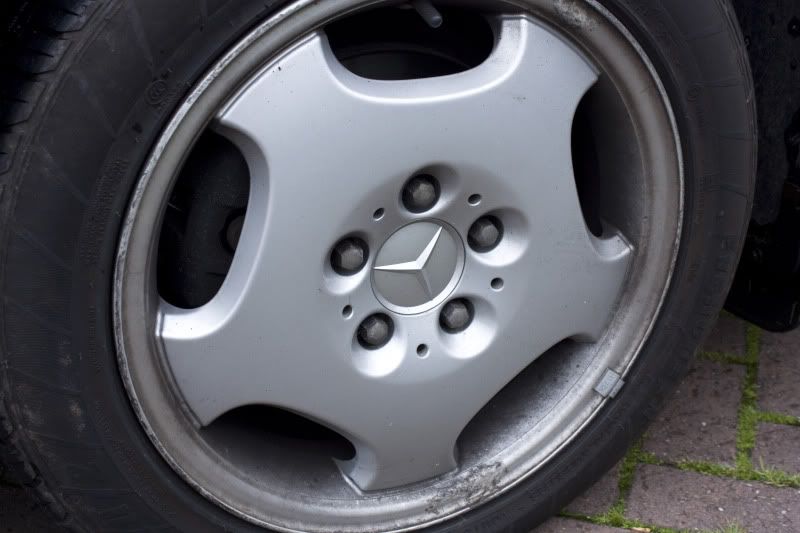

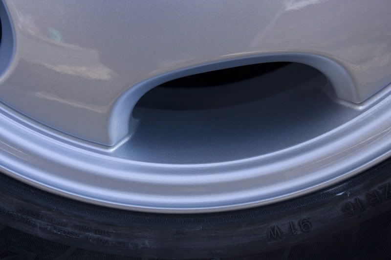

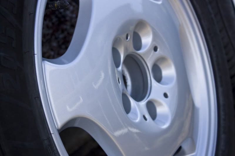

All the time this was going on, the wheels were also being worked on and refurbished...

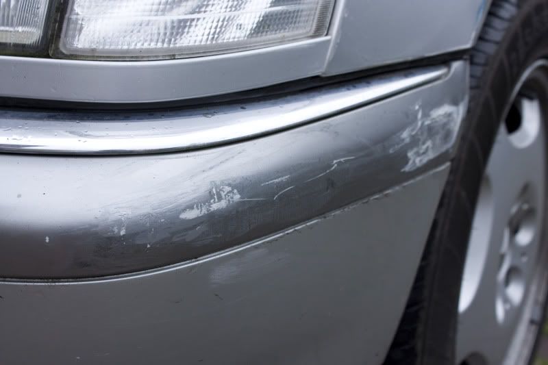

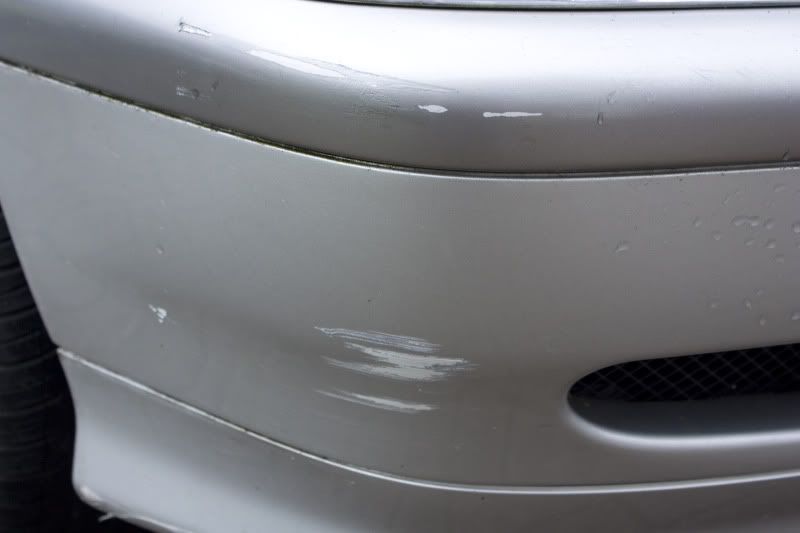

The bumpers were also taken off to my paint shop for repair - when they arrived back I refined the finish to the same high gloss level as the rest of the car.

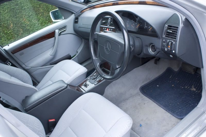

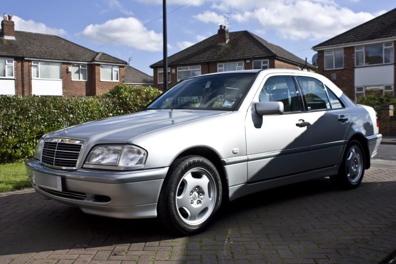

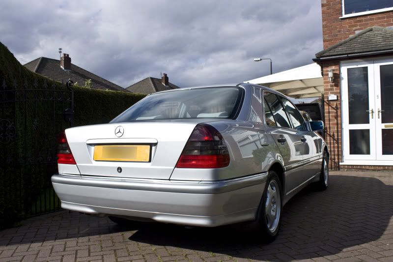

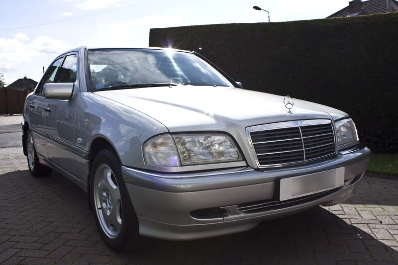

And finally, after re-washing the car down to remove all the polishing dust I was able to apply the finishing touches. In this instance, 2 layers of Zaino Z2 sealant and after 2hrs a final wipe down with Zaino Z8. Between coats I worked on the interior and dressed all the trim, including the grill and other chrome work, which when added together with 50hrs work overall;
The only thing missing was the 'elegance' badges from the front quarter side strips - my local dealer had none in stock, so the car is coming back for those to be re-fitted at a later date.
Thanks for reading! If you made it this far you did well! But I hope you enjoyed looking at my work :)
