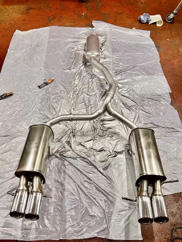

I also thought I’d polish the exhaust :D
Before
During
After
Before
During
After

Stunning. Better than factory. I love watching M539 on YouTube doing this sort of thing to various 20 year old Bimmers.
