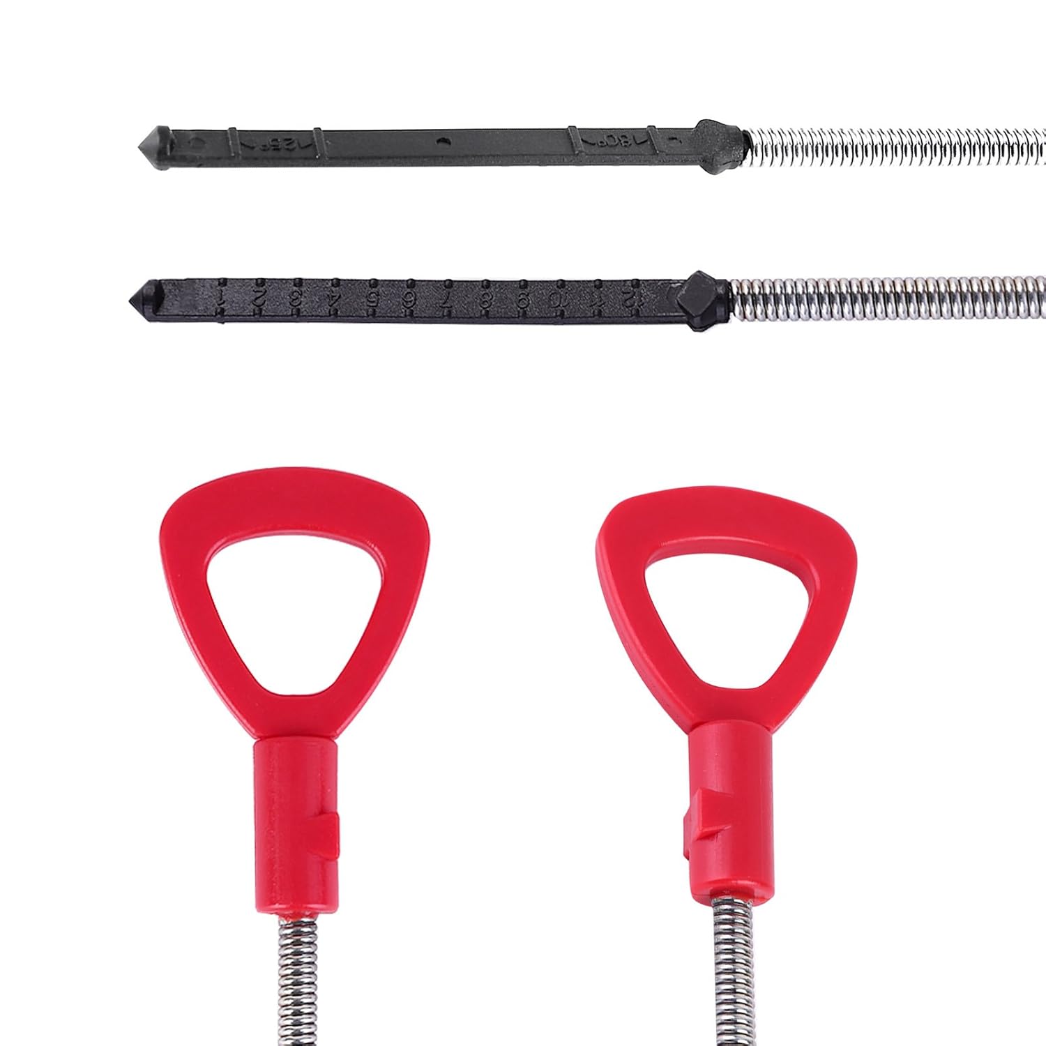

Assuming you have a 722.6 gearbox (5 speed), you can purchase a dipstick to check the fluid level. The fluid level is checked with it up to full working temperature and with the engine running.

Thanks for the reply … I did purchase a dip stick …. actually 2 dipsticks, as first one from ebay was no use at all. Even second one …. which cost me £15, wasn't any use as it didn't seem to have a positive 'stop', so you could push it in too far and therefore no accurate measure of oil level was possible.
I assume I'll need to buy a genuine MB dip stick … which will probably need a second mortgage to purchase!
As long as it has the little diamond stop, should be fine. Many available from Amazon. As above Sealey do a reasonably priced example
