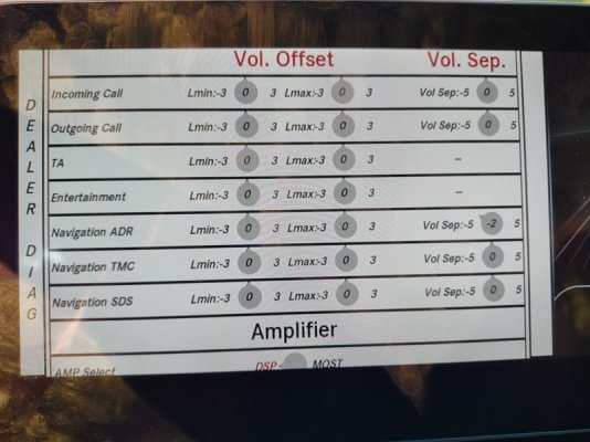

Hello All,
I need help, I have installed Android screen in my Mercedes B180, W248 which has NTG 5.1 stereo,
I have connected all the hardware correctly and I checked again, it is about AUX, Auxillary,
I am not able to hear anything what is playing on the New Android screen, (I can play radio, cd and from usb memory stick and SD memory card) But I need to set the NGT5 system to AUX audio.
I have tried the commands to get into Engineering mode, but my endcall+1+# doesn’t show up anything and only other 2 commans works, endcall+7+9 and endcall+3+* and I get only the Radio Frequency and some other setting in 2 commands,
Can you help me to get to Engineering mode? why that endcall+1+# doesn’t show up?
I will really appreciate if you can help me please.
I am attaching 2 photos of the commands I get and the Android stereo I installed. but one another photo I show you, I have written in RED, that is what I need the command to get to that HW setting to select AUX.
Thank You.

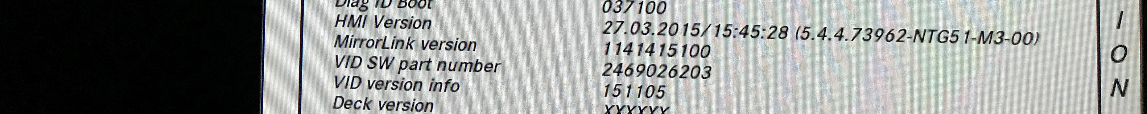

I think I have a similar issue here. I can see the carplay in the engineer mode but it is not active. I have GLA 2015. Do I need this dongle?
The dongles don't work on the last few releases of the software for the head-unit and if you want a bug-free experience then you need the more recent firmware. Talk to comandonline.co.uk about having it done properly (licence purchased, Datacard updated, firmware updated etc, appropriate hardware changes if needed).
