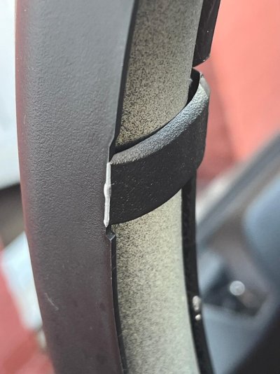

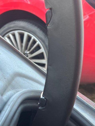

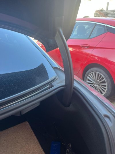

I have ordered 2 new gas struts for my 2018 E350d Coupe (C238) but cannot see how to get to the old ones to replace them. It seems pretty straightforward for just about any other car but with mine you can't see the struts and no amount of googling seems to help. I would start removing things to see what's going on but those plastic clips (see pics) look pretty weak so I don't want to pry them open unless I know I need to. Thanks In advance.

That doesnt use struts, it will use springs which are inside the boot, at the sides of the parcel shelf, behind the boot trim.

Now that makes sense as I couldn't figure how those things would fit. Thanks!
