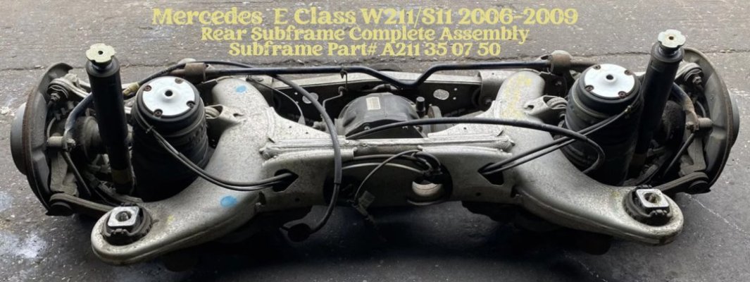

Rather than trying to replace just the damaged arms - potentially to find other damaged bits when at it - thinking about trying to replace the whole rear subframe assembly complete - all arms, wheel carriers, shocks, etc.
I have access to WIS.
Does anyone have any experience / tips / advice around this? - Things to watch out for / tricky bits / gotchas - while removing / installing?
Have done plenty of Google searching and not turned up anything.
WIS says:
  1. replace rather then reuse the big 4 bolts (A0029907422) that hold the subframe to the body. How necessary is this really?
  2. removal of the rear air springs will break the retaining clips to the frame foor. I plan to port the recently fitted Arnott A-2726s from my car to the new subframe. I can't see anything in EPC or Arnott about these clips being available separately, or even see what they are? Anyone know more about this?
  3. Apply color markings indicating the position of the propeller shaft relative to the rear axle differential (50) and the propeller shaft center support bearing to ensure that the components are fitted at the correct ex-factory positions on reinstallation, otherwise drive line vibrations may occur. Do I need to ask breaker I am getting subframe from to mark this for me on removal, or will it be 'pot luck' when fitting donor diff to my propshaft?
I know I'll need to get ride height checked and 4 wheel laser alignment afterwards.
Am I right in thinking a rear subframe assemby for any S211 2006-2009 should be suitable, so long as it doesn't have airmatic? - i.e. E280 / E320 ok as well, not just E220?
Any advice on sourcing a complete rear subframe assembly from a breaker?
Any common wear bits likely to need replacement on donor subframe - bushes? - Thinking I can order-up from AutoDoc with their 'safe returns' policy, to have on standby if needed. But I guess the best thing to do would be to get the donor subframe, check it over, and take it from there. (But I was aiming for not inconviencing my mate but having him trip over it as his garage for weeks while awaiting replacement bits - rather to have them lined-up and waiting so can 'go' when the subframe arrives.)
TIA.

  • have managed to identify the air spring clips required - A2113280058
Found differences between E280 / E320 CDI complete rear-subframe assembly and that on my E220CDI. Mainly because 3 litre has 7 speed box vs 5 speed on the 2.1 litre.
  • diffs are different and have different ratios - E220 1:2.82, E320 1:2.65
  • axle shafts are different
  • few extra nuts & washers on the suspension arms on the E220
  • brake calipers (E220 A0024202583 - 57mm inner width vs 67mm A0024202783 on the E320)
  • ...none of which is probably a big issue, but....propshafts are different - 3-bolt to diff on the E220 and 4-bolt on the E320
Has anyone sucessfully fitted an E280 / E320 S211 rear subframe assembly / diff to an E220?
- Possible to do by (just) swapping-out rear section of propshaft?
Getting a donor S211 E220CDI rear subframe assembly at a reasonable price is proving trickier than I had imagined - so may have to go to replacing arms route.
