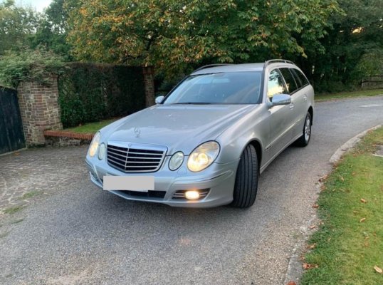

I've sent a few emails out to auto locksmiths this morning to get a quote for a new key so that I've a spare. Here's a picture of my first Mercedes
