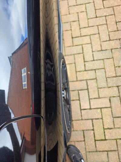

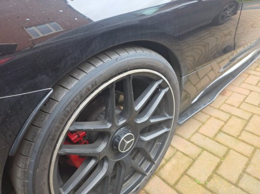

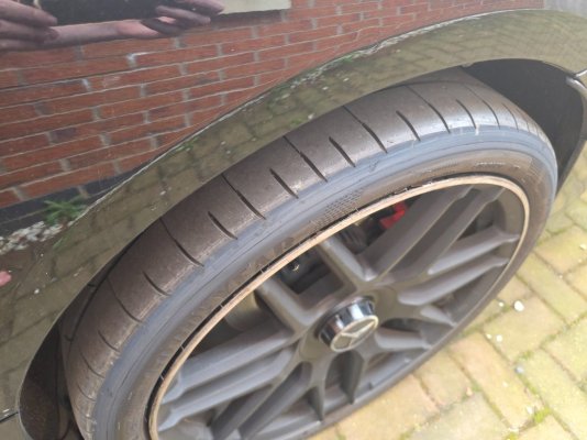

Sorry people! Yes they are 20 inch rims. Here are the images.
Im not sure why they put these on there tbh if it just causes issues.
Maybe I can use the same rims but put 255/35/20 on there?
Full alignment has been done and they are wearing evenly just this rubbing 🤦‍♂️

Car is a 2016 C220d reg is DC08 MBS if anyone wants it i think its classed as a C205. Do we think it will need new rims and tyres? Im really lost and slightly pissed off at the garage for selling me it like this but my fault i guess for not checking 🤦‍♂️
Looking at the second set, it might just pass the test.....but that's no help as far as it rubbing the metalwork of course.
I've had no issues at the MOT so i'd say its just passable but I want to correct it now before I throw money at tyres tbh!

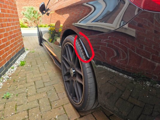

I think they are rubbing on the plastic mudguard I have circled in the picture. Or it could be on the arch itself I'm not sure.
It dosent rub all the time its just over bumps in the road or when the car has rear passengers/luggage! Pain in the **** 😢
There will be 'witness marks' where there's rubbing. If only the mudguard, can it be removed? If it's rubbing on steel - corrosion will surely ensue.
