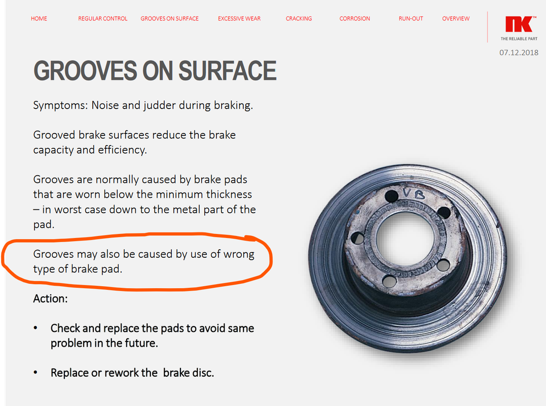

Is it primarily on cars with drilled discs that are getting close to the end of their service life?
Maybe this?
(From https://www.nk-autoparts.com/media/1433/brake-discs-failure-guide.pdf )
Using pads and discs from different manufacturers?
BTW, having Googled it, there are plenty of images online showing badly grooved discs, which are not drilled discs, so I don't think the drilling is the issue.
