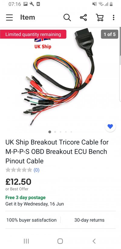

Well I'm thinking of buying the diagnostic kit to try and see what the problem is...could anyone recommend one for the job..I've saw this one on ebay recommended for the w124..any help would be appreciated..thanks in advance 🙂👍
