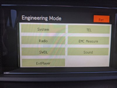

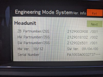

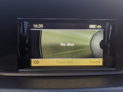

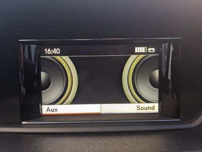

Hello everyone. Just got my 2010 E350 estate (S212) and wanted to use the aux input in the glovebox but i get no sound on any devices i try.
Here are some pictures of my head unit and some of the menus. If anyone knows what could be the issue with the no sound from the aux and also what NTG version it is. I suspect it is NTG4 from my 2 days of googling but none of the online pictures or videos look like mine.
The car has Navigation 20 (560) in the vin decoder and Radio Audio 20 (523)
Thank you in advance
IMG_20200128_163943.jpg IMG_20200128_164010.jpg IMG_20200128_164031.jpg IMG_20200128_164039.jpg IMG_20200128_164057.jpg IMG_20200128_164107.jpg
Have you tried increasing the volume on the unit and on the media player you want use? Aux volume has to be increased a lot in order to hear anything
And, yes, thats a NTG4 Audio-20 made by Panasonic.
