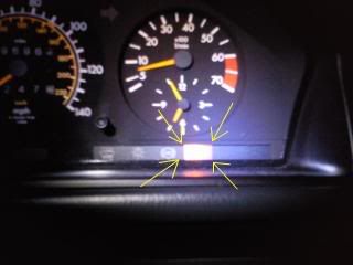

Nov 7, 2008 #1 A apollo201 New Member Joined Sep 20, 2008 Messages 6 Location glasgow Car 1990 230 ce auto there is a ligth coming on and off on my dash board with no picture in it its just a white ligth arrowed in the pic below if you no what it is or have an idea please let me no thanks mick
Nov 7, 2008 #2 A andy_k MB Enthusiast Joined Apr 23, 2003 Messages 5,204 Location Bexhill, East sussex Car Alfa GTV 3.0 if that's the same as our W124 dash layout then that is your SRS light and indicates an airbag fault. the fact it's intermittent rather than constant would suggest there is probably a loose or worn connection somewhere It should come on for about five seconds when you first start the car and then go out. Last edited: Nov 7, 2008
Nov 7, 2008 #3 nick mercedes MB Enthusiast Joined Jan 8, 2003 Messages 7,106 Location far far away Car Ford Expedition apollo201 said: there is a ligth coming on and off on my dash board with no picture in it its just a white ligth arrowed in the pic below if you no what it is or have an idea please let me no thanks mick Click to expand... It may be that someone has had the cluster out at some point and put the abs warning bulb back in the wrong hole?
