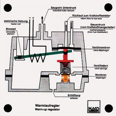

Paul I dont think you going down the right path but - .It is not unknown for the WUR to go wrong and fail and seize up . And often the rivets holding them to gether can be drilled out to service the WUR thats its name by the way .There is a service kit to do it yourself - Google for a repair company who will rebuild it for you bbb122d1-4dfe-48f2-bf1d-8a7f0dcc307b_k+jet+warmup+reg.jpg for you .See picture of WUR . I can find you a picture of its location on the engine if you dont know where it is .
That's very helpful - thanks. I've searched on the engine itself and in partial tear-down pictures on the web, but I can't identify its location. If you could post a location, preferably on the m102.982 engine, that would be great.

Definitely. Thanks for the link - question is, does the KE Jetronic also have the WUR? The car's daily driver, my son, is away on a trip with it, so I won't be able to check myself until they return tomorrow.
Paul
The KE does not have a WUR ---- post starting enrichment is achieved by the electro hydraulic pressure regulator. see page 17 onwards
