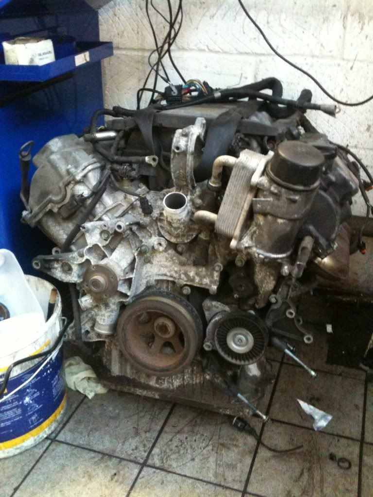

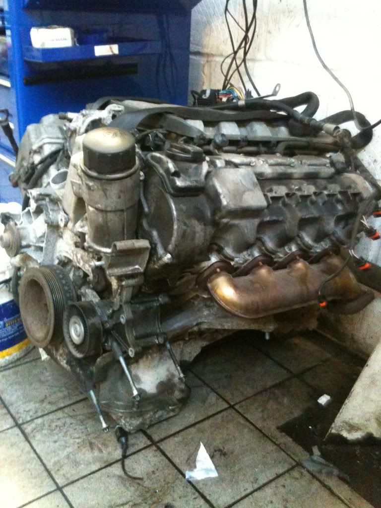

hi i paid 730 for it of ebay the guy had a coulpe of 55 engines and its supposed millage is 140000 its looks good with no bad oil leakes.
the plan is to replace the timing chain tensoiner and guides water pump head gaskets valve steam seals tappets. i also got some nice headers from the states. any way ill post some pics when i start

the main reason for my rebuild is i want to replace the timing chain kit (chain guides tensoiner) so heads off. while the heads are off ill have them ported and polished also ill re lap the valves and clean the engine internals

ok ive brought
timing chain kit
center gear
head gasket kit left and right
head bolts
front and rear crank seal
water pump
thermostat
engine mounts
gearbox mount

hi there yep the re build is going fine just waiting for one more part from mercs then i can put it all backso it looks like a engine again:thumb:
