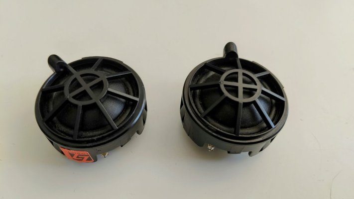

I found really cheap original H/K tweeters from RRR.LT, so ordered them figuring they gotta be better than my crappy ones. What's your opinion about the H/K speakers? There are quite a few midrange/midbass woofers too, or should I go with brand new aftermarket ones?

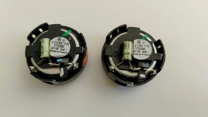

Got these from Latvia today.
I'll swap these into the car today, hopefully they are way better than the basic ones. But there are more goodies waiting in my garage, a complete speaker kit (Onkyo P-S625C2) to be installed once all the sound deadening material I ordered arrives.
The tweeters are installed, and they're way better than the old ones. It's actually possible to hear all sorts of instruments in my music now!

The H/K tweeters are indeed plug and play, easy to swap. And they are also much better than the crappy ones in the Audio 20 system, the €20 I payed for them with shipping was absolutely worth it! I say go for it.

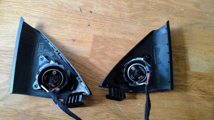

Here's the H/K tweeters in my original sail panels.

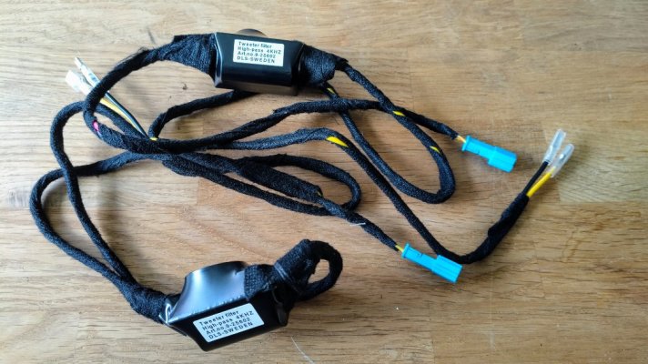

Had a somewhat difficult afternoon today replacing the front left woofer with the Onkyo 6.5". The crossover is big enough to give me way too much trouble fitting it in the door. After much trial and error along with some cursing I decided to let it be for now, just going with the H/K tweeters and the Onkyo woofers. Will probably find a place for the crossovers eventually. The Onkyo tweeters are a bit too big to fit in the sail panels fittings, soon I'll buy a another set of them at the breaker for modification for the tweeters.

Will replace the tweeters too in due time, as soon as set of smaller crossovers and a pair of used sail panels arrive next week. The H/K tweeters are fine but I prefer a litte warmer sound, and from what I could hear in the shop demo rack the Onkyo tweeters will give me exactly that.

The crossovers and tweeters in the Onkyo kit I got turned out to be too big to fit reasonably easy in my doors. Instead I bought a used set of sail panels and another set of silk dome tweeters and crossovers, and I'm pretty happy with the result.
Had to modify the sail panels slightly to fit the tweeters, but I still have the original ones if I need to restore everything. Didn't cut any of the wiring in the car either.
