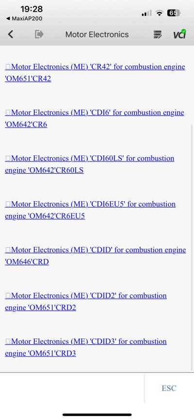

So I brought an Autel AP200 (I have to say the app isn't great (let alone having two apps for the same job), however I can't get it to load/connect up the Service Options properly, I always end up at the menu below, and none of the options appear to load up (just sit on the loading screens).

Yup, I loaded the 'Benz' plugin, and it detects the VIN, but after choosing the Digital Motor Electronics, it fails the detection and presents me with the menu options listed previously....

Yes I do the automatic scan above, and it's after that point it fails with a can't detect xxx and gives me the list of what engine/code to choose. :)

You can see the below stages I captured - it works up until the 3rd picture and scans the Motor Electronics, then I get the list (in blue text) that it can't find the Motor Electronics and to choose from the list, so I chose the same as you (I have tried others options with no luck) 'CDID2' and then it scans again, last two pictures, but I waited 7 minutes (see highlight in yellow on screen shots), and gave up in the end.
