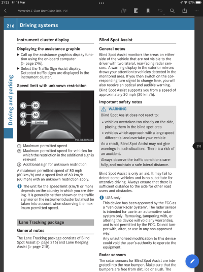

I don’t know, it just worked from day one. I’ve had a look in the manual and found this
And this is page 246
If you don’t have it as traffic sign assist on the driver’s display, I would expect to see it in the sat nav, but of course the data could be out of date on the satnav while traffic sign assist actually reads the signs.
