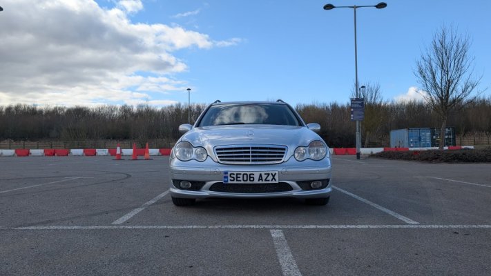

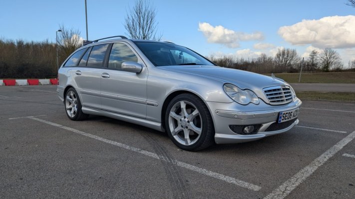

Pictures after a full DA machine polish:
She scrubs up well!
