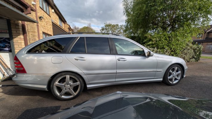

Bought a set of staggered 18" AMG Style III (I think) alloys for dirt cheap. They are in a bad shape and one isn't holding air FFS.
Test fitted one of the rears:
These are often overlooked as they could normally only be found on the 2nd Gen A-Class as well as the SLK but I love the look of them.

My bro in law had those on his from new 2004 W203. I like them.
