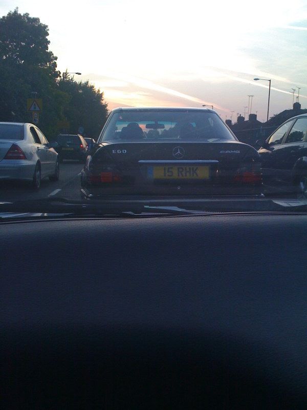

Spotted this on the A40,it was unusually fast as my mate was following it in a mitsubishi gto twin turbo:)
Wow, amazing, an E60 on the roads...
Here is that one I think...seen underneath a Hotel in London
yes thats the same one,15 RHK...the guy who drives it is really nice,when me and my mate caught up with him,he told me about the E60 and that theres only 11 of them here apparently,it has something like 420bhp..it was really fast and the car was in mint condition..
Nice...did you ask him to sell it to you??????????
