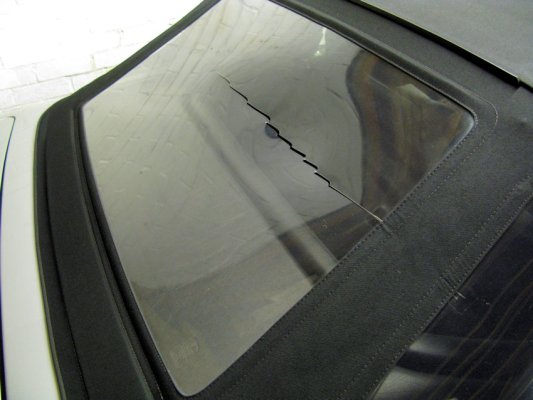

Sorry one more Q, is it possible o change the rear plastic on the soft top, its gone cloudy and rear visibility isn't good.. if not is there a good way to clean it, thinking of wet n dry as to how we clean the light clusters from all the dirt they pick up.. similar approach or no ?

as for the rear plastic window, think they can be polished though maybe not wet and dry.. there are companies about that will replace them, bit of Google searching should reveal all.. enjoy the summer and nice evening drives..
The windows in the hood have a limited lifespan, particularly if the car is parked outside. Apart from eventually going milky/cloudy they develop little cracks at the edge on the fold line, and will eventually split all the way across. As above there are various companies that will remove the hood, replace the windows & re-fit (assuming the hood itself is in good condition). This is my rear window - it split like this literally overnight after having tiny cracks at the edges for perhaps 6 months. There's a fair bit of tension on it when the hood is up.
