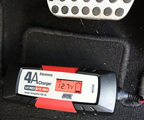

Would this be ok for an AGM battery, does it need a special charger?

Personally I'd get the CTEX MXS 5.0, one of the best things I've ever bought.
I've charged my wifes A220, my neighbours 16 year old ford fiesta, my 4ltr E63, and my neighbours 5ltr CLK500.
The Maypole charger above would only have been able to do two of those cars given the picture posted, but all depends on your requirements I suppose.

It will still charge them, just take a little longer because of the lower current rating.

Treble the cost and no screen 😮

I've got both a CTEK MXS 5.0 and a cheaper device similar to that Maypole one. For an occasional top-up of my main car I'm happy to use the cheap one. For my other car that is connected to a charger 24/7, I use the CTEK: I sleep better knowing that the unattended charger connected to a potentially explosive battery is universally highly rated rather than just built down to a price. I've got no issue with other people being perfectly content with a cheaper device - I'm usually quite thrifty myself - but I'm happy with my CTEK.

The inclusion of an LCD display is a bit of a non-issue for me because, apart from a vague interest in the voltage when I plug it in, I'm just waiting for the 'full' indication. When I bought my cheap charger for occasional use I actually did choose one with a display, as I thought the extra information might be useful, but in practice I find that status LEDs are clearer and easier to digest than the tiny graphics on the LCD panel; I have to squint at it to confirm that the settings are all correct. Maybe I'm just getting old.
The starting voltage is good because you know how healthy the battery is
The screen is orange when charging and green when charged , it couldn't be simpler .

Yep the Maypole has all the above settings too .

I'd be worried about the maypole because it says in the advert that it's only suitable for engines up to 2.5 litres.

It's a battery it's charging not an engine .
No eye deer , the most bizarre info can be advertised , like 200 bhp brake pads !
Higher the Ah , it's just going to take longer , when it's there it's trickled and trickle chargers if purchased on their own are 1.5A .
The thinking is that a bigger engine will have a bigger starter battery. For normal slow charging this just means it will take longer to reach full charge. In addition I expect that features such as reconditioning will be less effective if the charger doesn't have an appropriate current capacity - although the value of reconditioning is not universally accepted. Also, some people may have unwarranted preconceptions about how long a charger should take to charge, and by saying that the charger is only suitable up to a certain engine size/battery capacity the manufacturer may avoid some negative feedback or returns from such people when they expected their 4A charger to recharge their truck by lunchtime.
But just going on engine size is a very poor guide to battery capacity: a 2-litre diesel will have a bigger battery than a 3-litre petrol and different battery types (AGM, etc.) add more variables. So you can ignore the 'up to 2.5 litres' claim and go on charging current instead: CTEK and some other brands produce a range of models with different current capacities, and most modern chargers have at least two current settings.
