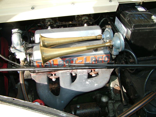

A feeble one is better than none. Of course, if I had the time, skill, madness and money I'd fit something like these - proper set of horns.
Air horns...nice and loud, but they always seem to take ages to actually start 'blaring' - at least they do when you are bearing down on something hard at toomany mph...
That reminds me, while my Allard has a proper horn, it probably needs one with a bit more oomph, as its stopping distance is somewhat longer than the audible range of the horn I suspect..
I would hope the music from the exhausts would provide adequate 'warning of approach'.
With drum brakes, waiting for the air horns to come on gave me something to do while waiting for the brakes to 'come on'...
