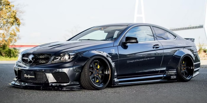

Heres my bog stock car I just bought Mr Insurance man.
Honest.......no mods.....at least as far as I know!!!.....! I think you would find that "ignorance is no defence" rule would apply here if....and its a big if .....they found your car to be modified after a claim.
Did you ram raid Halfords backwards?
