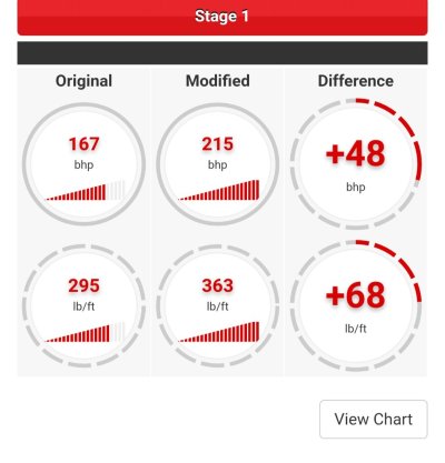

So I could have my 220 "mapped" to run faster and more economically without a problem? Genuine question BTW as mechaniking is a black art to me! Lol
A 220 on a soft/safe map would give you approximately an extra 50 bhp and 60 1bs torque

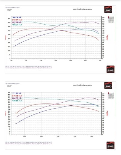

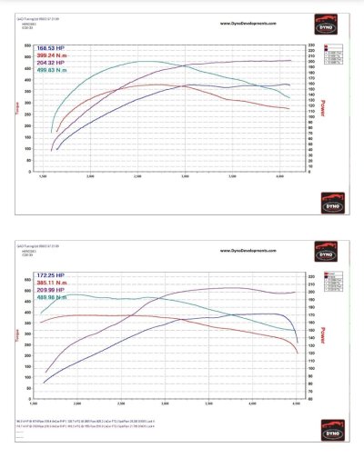

Tuning boxes do not put out the figures they claim .
RaceChip even ended up in court in Stuttgart .

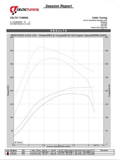

The one remapper I've caught out many times before.
Can you see the problem here ?

Interesting... Partly straight lies, partly not comparing like with like... Would a Sprint Booster help at all, do you think... :devil: ;)
(I had a Celtic Tuning 'remap' on the R171 SLK 55; no discernible difference in anything. The inline six diesel in the E320 I bought had a TDI tuning box already fitted, and I was quite impressed, but the turbo lag was very noticeable - a bit like a two-stroke bike; trundle trundle trundle WHOOSH! - bugger, run out of puff, drops off the cam as it changes gear - trundle trundle trundle WHOOSH! - repeat as required...).

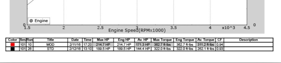

I can see several...
  • Standard run took place after the modified one :fail:
  • CF is on the absolute limit of what should be considered acceptable for an accurate measurement.
  • All of the parametric values for each run are omitted.
Spot on presentation for an "Emperor's new clothes" remap though.
Er.... Std 13:10, Mod 17:20.
It's a typo, obviously, with the runs three hours apart. Nothing else fits.
Do you really believe anyone would do this?
That's not how those charts work, reputable dyno software automatically logs the date/time at the beginning of the run. They were better off being the wrong way round, manual intervention on that table just digs the hole deeper.
