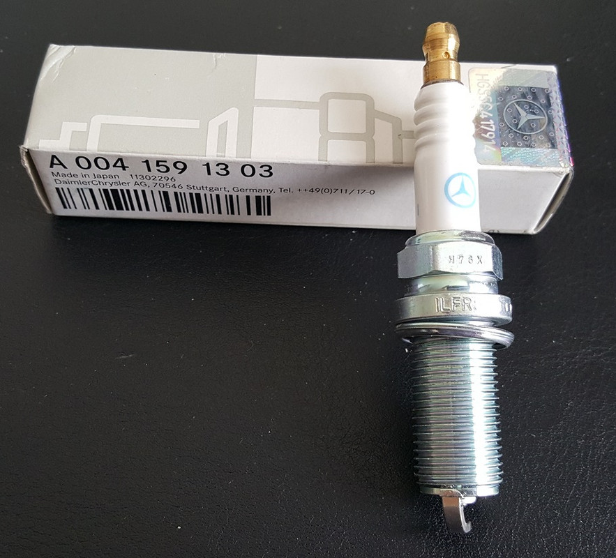

Mercedes Benz of Newcastle have a set of genuine spark plugs for a reasonable price mate @W1ghty
The genuine MB spark plug for the M271 143bhp engine is Bosch FR6MPP332 - A 004 159 45 03.
NGK recommend ILFR6A (Iridium tip), which they refer to as 'Upgrade'.
Interestingly, you can get MB-branded NGK ILFR6A from MB - A 004 159 13 03:
Though MB never actually specified them for the M271.....
