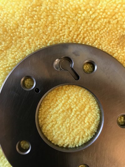

Just used the same repair kit on my C63, only done 36K with full dealer service history, as seems the case inlet side was the main culprit. Much better now completed, import TAX was a bit of a shock but still worked out cheaper than on new cam adjuster.
Thanks for the info on C63Motorsport saved me a fortune!

Looks like there are a few of us going down the route of replacing the plates, which is a permanent fix. I have my stage1 plates purchased from 63motorsport, will be doing the SLS bs buckets and whilst there will check on the headbolts and see if it needs upgrading to the newer design. Will be doing myself, so in the long run will save on labour. I'll make a part number list in my other thread for anyone wanting to DIY.

Is there a definitive how to guide on replacing the plates including the tools needed, torque settings etc…?

06 -08 (ish) have the T55 female bolts, they have slightly more meat at the top than the T60 female bolts, so a little stronger.
Both T55 and T60 female head bolts have been replaced with the male version but i wonder why MB switched in the first place from T55 to T60, makes no sense??🤔
This is great info.
Yeah there are a few videos floating about on YouTube, I particularly like Tasos, his videos are pretty good. The torque setting for the adjuster is 25nm but not more than that and a little locktight wouldn't go miss.
