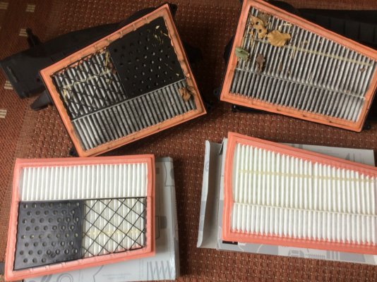

Second update for anyone interested. The air filters were absolutely filthy, black, rammed with flies and bees and leaves (apparently change at 20k miles ago by a reputable independent, not sure if that adds up but maybe). Two new air filters = no change in mpg lol! :oops:
But, whenever I floored it to the floor previously it would trigger a EML on the dash, but not now. I think at low revs the air filter resistance was low but at high air flow it was more significant and a sensor somewhere didn't like it.

I recently changed the filters on mine, and had a resulting noticeable decrease in reported trip computer economy! Until I had a new air filter reset applied.

To save you a long read of thread derailments, if the filters are very dirty pre-change, it's worth getting an air filter adaptation reset on install of new filters. But the Merc ECU will eventually learn to work correctly with the new filters I believe.
Now the weather has warmed up I'm getting a bit more economy. My last tank based on longer trips for the week, was 38 mpg, which I suppose is acceptable for a car with similar torque to an AMG and is very very smooth compared to most diesels 👍
They get very dirty very quickly , I think these are 18months 10-12k miles
20 k miles is a long time to be in use for the air filters so I’m surprised you were surprised they were dirty !
The new style filters stay surprisingly cleaner for some reason. Could be the areas we live in I suppose. Saying that my e350 came from Scotland and my glc from Cheshire. Both sets were pretty clean after 20k + miles.

The manufacturers change is 40k miles , maybe that’s why he is surprised ?
