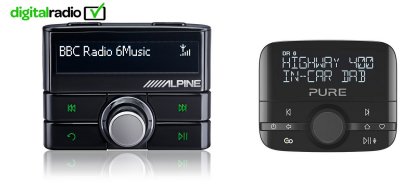

Now, is it me, or does the Alpine converter look virtually the same as the newer Pure converter, but with a different badge? :)
LOL, you see, I like the Pure one better, neater control panel, nice clear display, and I've hated Alpine sine I had 2 consecutive head units go faulty on me in the 80s! But they are often fitted as standard to Lamborghini, so maybe they know how to make them better these days...
