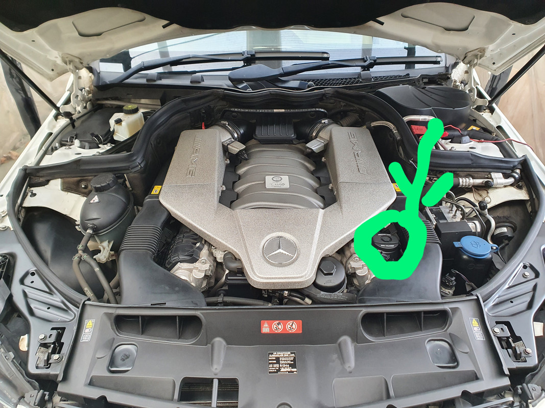

Hi I've also got the c63 I've never had that up on mine but mine hasn't really used any oil the top up is on thr righthand side ill post a pic ive only done 400 miles since service ,i only check oil cold aswell 😅
Thanks, fella. Appreciate you taking the pic - grateful! Mine is 1155 miles post last service. I did locate the cap and with a little help from a 17mm wrench / spanner or whatever, it opened easily. I'll wait for daylight tomorrow to do another check of the dipstick and then hopefully top it up. Fingers crossed and touch wood, the message won't then come up 😅
Just DONT put to much in and enjoy 👍

An oil top up is easy, just make sure you are filling in the correct place as indicated in the diagram in Post #31 . It's just like doing an enema;)
As mentioned. 0.5lt, wait 10 mins for the oil to drain down and recheck the level.
