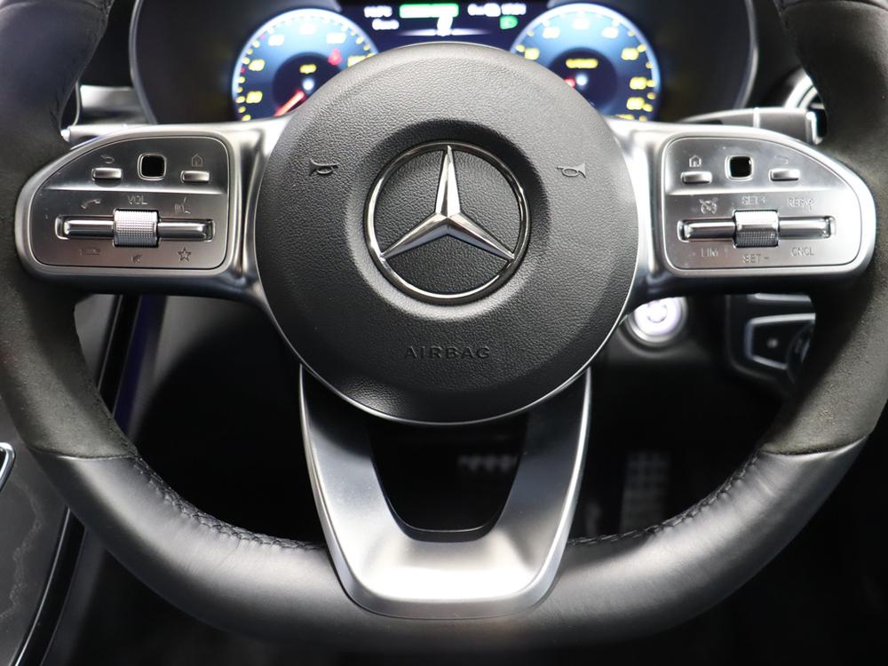

I thought I was limiting the speed - at 50mph - and the car would brake and accelerate (to 50mph - the limit I had set) according to traffic conditions. That's what I am asking for help with here as the dealer hasn't been helpful thus far.
Speed Limiter: RH Toggle Switch with the "Clock" above it, once Set Limits the Speed the Car goes at, as far as I am aware is overidable using the Accelerator!
Cruise Control: Far RH Toggle Switch Sets or Cancels, Centre Toggle Switch can be used to increment the Speed (or decrease) by 1 to 5 MPH depending how it is used, as far as I am aware the Cruise Control will allow your Car to travel at the Speed Set UNTIL you approach Slow and or Static Traffic! (Distronic) When the Traffic moves on or Speeds up the Car will revert to the Speed Setting!
Which one are you Using? :oops:
One other point is that if you push the far right switch up twice it will then follow the speed limits automatically.
