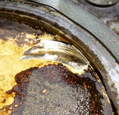

In all the ones we have done over the years, we have ever only seen one piston cracked, and we have done many.
Im with you on that 1 ive never came across 1 either, if the head was removed by a competent mechanic you could tell from there to what extent the damage was, it's all guess work until the head is removed 🙄
