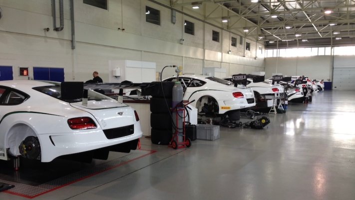

I met Elfyn quite a few times when I was working up at M-Sport in the Lake District where we built the GT3 Bentleys. There were countless rally Fiestas on the other side of the workshop. Elfyn was a quiet, unassuming lad almost always in overalls and working on the cars, but also driving very quickly on rallies at the weekends. I introduced them to the idea of having a 'function checklist' instead of just taking the rally cars up the road for a blast to see if 'they felt right'.....
