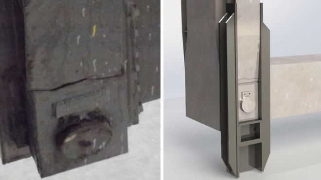

With reference to the pic posted by Graham in #27 this part of his report is significant.
"2.4.6 Bearings The suspension bridge deck and approach viaduct decks are provided with bearings to permit movement arising from temperature, traffic and wind effects. At the main towers, the deck is supported on truss linkages which allow longitudinal movement. FETA report that some of the bearings at the ends of the linkages may have seized and require replacement or refurbishment."
There are sixteen of these :eek:.
It is my understanding that better quality lubricants (which in all probability would have prevented the seizures) were offered but rejected. If they were not offered then I can say categorically that they were neither sought or used. The reason for this would have been the higher (initial) cost. This is what you get when accountants hold sway. Buy cheap buy dear.
Worse though is that the imbeciles will not realise their error and the accountant will get promoted on the back of their 'cost saving', the rectification costs not featuring in 'their budget'.

Wonder if they've x-rayed any of the other 15 to see if they're also cracked?
TRANSPORT SCOTLAND WEBSITE :- In addition to repairing the defect, Amey is taking preventative action on another seven similar locations on the bridge to prevent any issues from occuring and structural monitoring systems are also being installed at these locations.
I don't know what monitoring equipment they will use--- strain gauges? but whatever they may be they will have to contend with a pretty harsh environment.
So no one found an arc welder, and there will not be a welded joint in sight after the repair. Does that mean if you have a bit of chassis corrosion that needs welding you can nut and bolt a splint across the affected area is to pass an MOT, and just quote "to Forth Road Bridge Standards" to the MOT tester.
