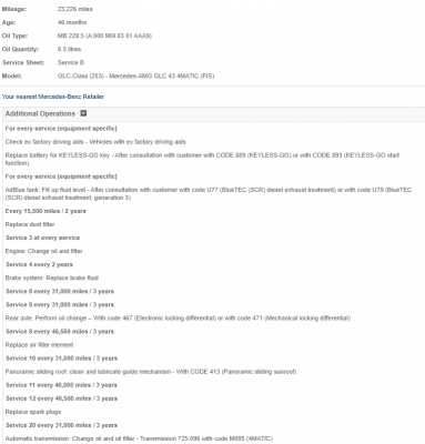

I looked up and this is what the service site showed me. From my understanding, did they say ATF is due as a result of the 3 year timeframe? If yes, then why didn't they do it last service when it was 3 years old, doesn't make sense to me.

The Electronic Service Sheet (ESS) is the maintenance schedule - looking at your screenshot the transmission service is due at 3 years or 31,000 miles.

It seems short to me too, but based on the screenshot that’s what ESS says
It actually says that an ATF and filter change is required for vehicles fitted with the 725.096 transmission. Is that definitely what's fitted to the OP's GLC43?
