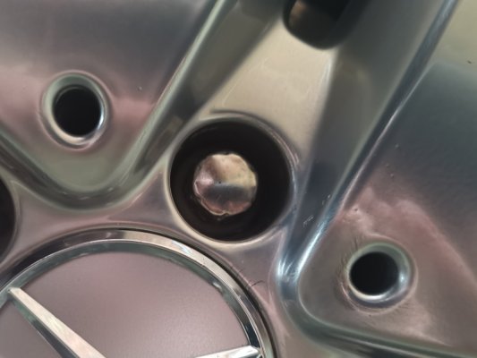

I recently had my wheel powder coated (really pleased with them) and today was checking the the bolts were still tight as recommended. All were fine except one which I could not check because it had been rounded off (probably by incorrect socket used or put on too tightly?). I have ordered a new bolt but how do I remove the rounded one?

Done it myself on a stubborn bolt once, i used one of them 12 point imperial sockets, that was ever so slightly too small, and i mean just, then basically smacked it on with a hammer, came off pretty easy after that, you will mess up the socket as well though
If all else fails, try a locking wheel bolt removal specialist, they make removing sheared locking wheel bolts look easy. They would no doubt be handy at removing a rounded bolt too.

I've been in contact with the company that did the powder coating for me. I'm taking the car over to them so they can remove the rounded bolt. Cheers
I have a set of these...come in useful more than once...but not on my own cars wheel bolts!
I've just been to my local A1 tyre fitters who kindly removed it FOC 😃
Possibly over torqued because someone has put copper grease on the threads; they need to be clean. Copper grease on the mating surface but not on the threads.

There is evidence of copper grease on the thread. I've ordered a few spare wheel bolts, a torque wrench and a Mercedes wheel nut socket. When they arrive I'll be removing all the bolts, cleaning the threads and replacing them with the correct torque (150Nm).
