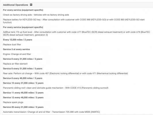

But when I used Mercedes's website to get a quote for service A at 20k miles, there's a lot more items that's required at 3 years (as in below). Specifically I am concerned about the spark plugs, transmission oil and rear axle oil change.
Now I can understand why the dealer didn't carry out all the tasks, they did say the car is due for a service and they'll give it a oil change, but I wasn't expecting there's that many tasks being ignored. I 'll probably only keep this car for a year (still wanting a GLE63s as I originally planned) but for keeping the car's value and considering that I want to take it to a track day in Sept, I 'd think it's best to book it in to get the rest items sorted? But will they (either a MB dealer or specialist) be able to carry out the additions ( so not changing the engine oil) and update the DBS to reflect the work?
Ah, the joyous mystery of MB service schedules.
The alternating A and B services are just oil changes and inspections. The B service inspection is deeper than the A but about the same as an MOT.
Other stuff like brake fluid (every 2 years), air filters, spark plugs, ATF etc etc crop up at varying intervals and are bolt ons (extra cost) to A and B services.
When I bought my CLS55 the local MB dealers couldn't explain service schedules or what my next service would be without plugging the car into their computer (£kerching).
So, starting with my owners' manual plus trawling the web I built a spreadsheet covering all service items / times / miles out to 150000 miles. Now I give my garage a checklist for each service to my requirements.
BTW the manual for our X-Trail gives all this info in plain sight.
The car's value has already taken a hit by the erratic service history: the first service was done two months late, the second five months late.
To preserve the car's history (and resell value), I think you have no choice but book it in for a service at a dealer, that includes all of the missing items.
That said, I would do that in October, which will be one year after the last dealer service. And I wouldn't worry about the 3-year items getting done seven months too late (car registered in March 2018, 3-year service done in October 2021), it's not an exact science.
Normally I am all for indie servicing, but in this case, a 3 years old AMG car with problematic service history, I would stick to dealer service to minimise the resell value loss.
I am assuming others might suggest to book the car now for only the 3-year items (without a Service A), and make sure they are ticked on the DSB. This is also an option, though personally I would just get it all done in October, it will make the car service history look better for a potential buyer - you'll have the last two services in order, and only a small hiccup earlier in the car's life. And you will also avoid the need to explain the odd service history in 2021.

Thanks a lot for the comments and advise. I must admit I didn't concern the previous service history that much given the mileage, I'm still in search for an GLE63s I'll make sure I go for one with all the SH inline with the intervals. Just hoping this won't be an expensive lesson!
So for the service advice, right now it has A-B-A services at 3Y4M, if I wait until Mar 2022 for the B service so overall it's had 4 services, A-B-A-B, over 4 years period. Would this looks better overall? But probably causing more issue with the 3 year items being done in year 4 service?
If this is not good idea then I'll go with your suggestion for Service B in Oct and cover the 3 years items at the same time.
