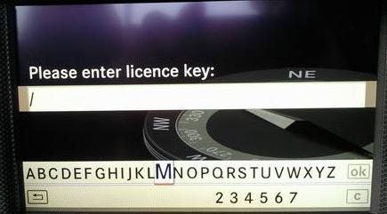

You need a PIN number to update the maps, available from MB dealer, COMAND.online.UK or ebay sellers from Lithuania, the maps can be downloaded for free, but without a PIN number at anything up to £200, you cannot upload them to your car.

Instructions and code were messaged when receipt of the dongle was confirmed. In truth instructions were not needed, as soon as the code was entered it updated and I just followed the screen prompts such as they were.
