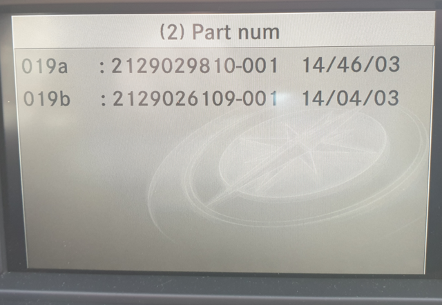

NTG4.7 I think (2015 SL400)
Check in the engineering menu.
These are the two latest firmware files for COMAND NTG4.5 Gen 3 (aka NTG4.7):
