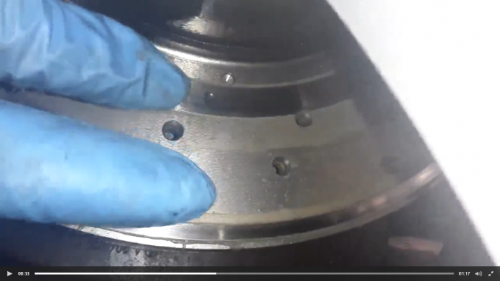

The technician did point out that the pads weren't contacting the whole area of the disc that they should, yet on the old discs it looks like they did. So this is another mystery now. I've included a pic here of that after three days wear
Any ideas why they wouldn't on the new but did on the old ones ??
