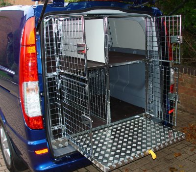

The rear seats are pretty high ... unless you've got loose stuff loaded up to the roof it's pretty unlikely anything could move forward. And if you get a Vito that has the roof lining, rear trim panels, soft floor, etc. (this was called the Comfort Pack when we bought ours) you definitely don't need a rear bulkhead from a noise POV. If you ignore our caging ;) you can see what I mean here:
View attachment 84271 View attachment 84272
Many thanks for the images and information.
I wasn't aware of the Comfort Pack option so that is very useful to know.
Thanks again.
It also includes rear speakers for the sound system - you can see a grille in the 1st pic. I posted, just behind the 2nd row seats.
I guess these interior trim panels were just Viano parts, like most of the Vito factory options. In fact if you look at the 2nd pic, just above the top tier cage floor, there are mounting points in the side panels to take a pull-out luggage cover.
